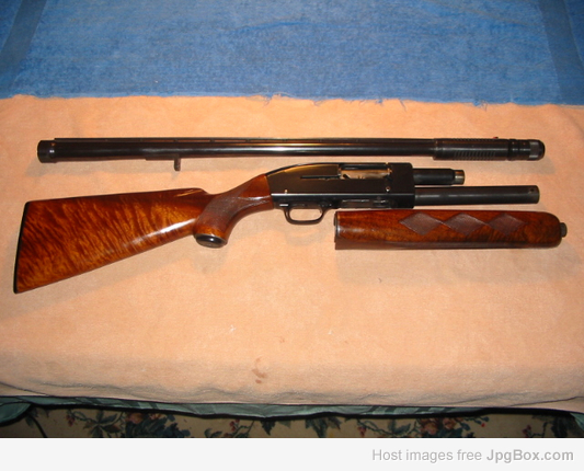

Discussion starter · #36 · (Edited)
heres a standard grade skeet with factory cutts and vari-choke.
