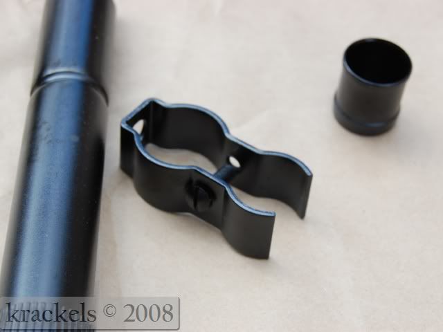

Here's the magazine extension tube; magazine clamp; and magazine follower curing in the oven.
The refinished and cured parts.

Magazine extension, magazine clamp, and follower. I think that's some oil from my hands on the barrel.
Magazine extension.

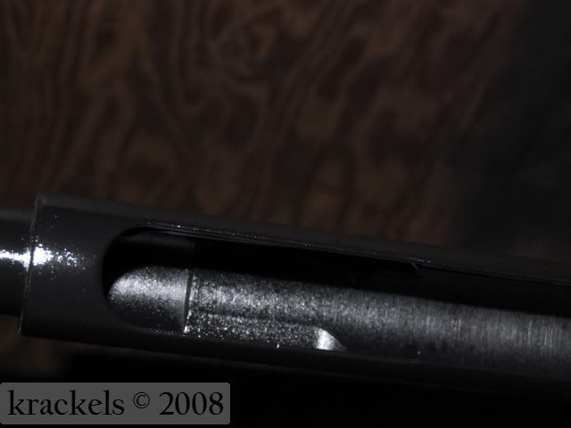

Inside the receiver. (do I have enough pics yet? and I'm actually deleting them as I go :shock:)
Just wanted to show that I sprayed the inside of the receiver. (it's amazing that the tolerance is close enough that I could feel the tightness when I put the bolt back in).
Another showing the inside of the receiver.

Close up of the receiver. The line is when I laid it down on the metal plate to cure. The rest of the time I hung it with coat hangers.
& another.
Trigger assembly, bolt, and slide rails weren't refinished.
& another.
