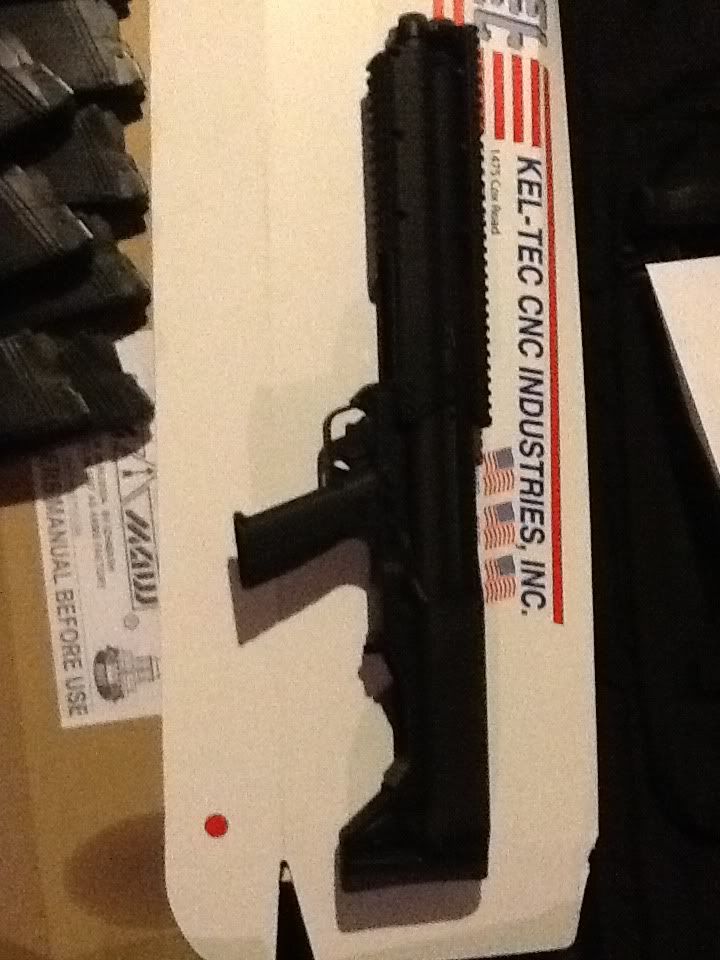

Well I'll be the first to say pics or didn't happen!!
Thankfully i didnt have to sell an organ to get one. Pic up in a minute as proof
Lol...i still do that when i see it. I cant believe i got one
Here she is.
