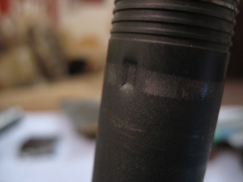

This little dimple is to keep the magazine spring keeper in the tube when you removed the barrel nut. Its in the way for the spring and follower that goes with the 10 round mag extension... I ground it out using a small bur in the dremel.
Looks good so far, except for that nasty hole in your magazine tube. ;)
I'm sure it will look much better after that's cleaned up and smoothed out.
