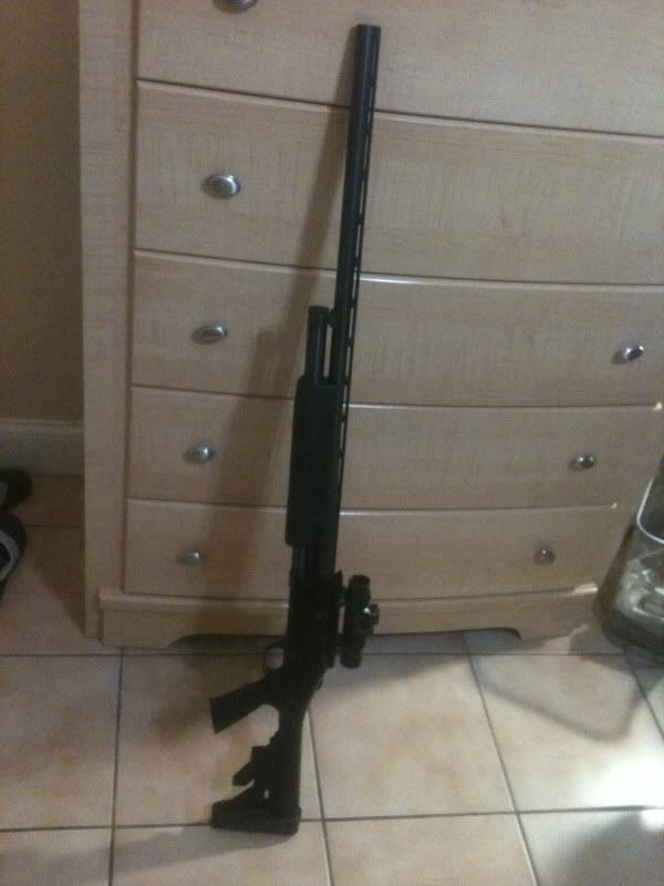

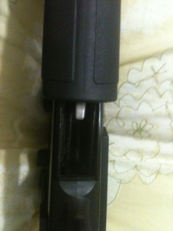

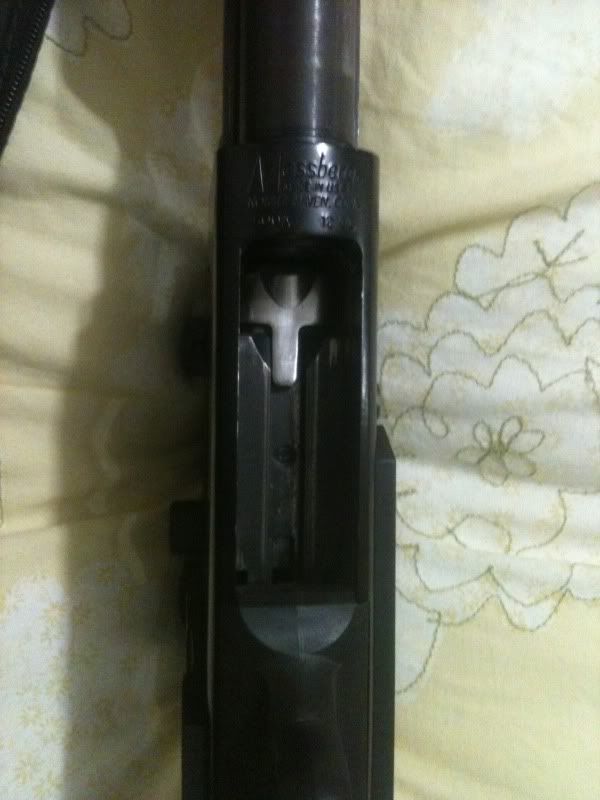

I am looking at a used Moosberg 500A and have never bought a shotgun before so wanted to make sure this is a decent gun. I just want one that is inexpensive so I can get the feel of one before spending more $$$. Besides I like the idea of a beater gun. This particular gun always has the bottom open and I feel like there sould be something covering it. I have included pics of what I am taking about. The second pic has the pump all the way back.
Discussion Starter · #5 ·
that's normal.
get rid of the pistol grip stock as it makes reaching the safety effectively impossible.
if you can find an 18.5" barrel instead of chopping up the 28" barrel, it'd be advisable.

I've had my mossberg 500a for a long time and have beat it to death and never failed. I used it in a 4'day defensive shotgun course and leanred that this Knox stock pistol grip is a pile of dog crap. Get rid of it. Also mine came with two barrels. One for hunting purpose and the other for HD. Look into it and you won't need another shotgun. You'll love it!

Yeah, like the others have said. Just get an 18.5" barrel so you can swap them back and forth.

As said above, I have one. Had an ati fold up stock but it makes getting to the safety a bitch. I took it off and painted my wood black. Found a used slug barrel, smoothe bore, and cut it to 19in. If you have the accu choke barrel, I def wouldn't cut it. That's the barrel mine came with, it appears your has it also. Plus the vent rib at the top would make it a bitch to cut that barrel down anyway.

As for the open bottom, that's where you load the shells. It would be kind of harder to load it if it were closed or had a lid over it or whatever.
