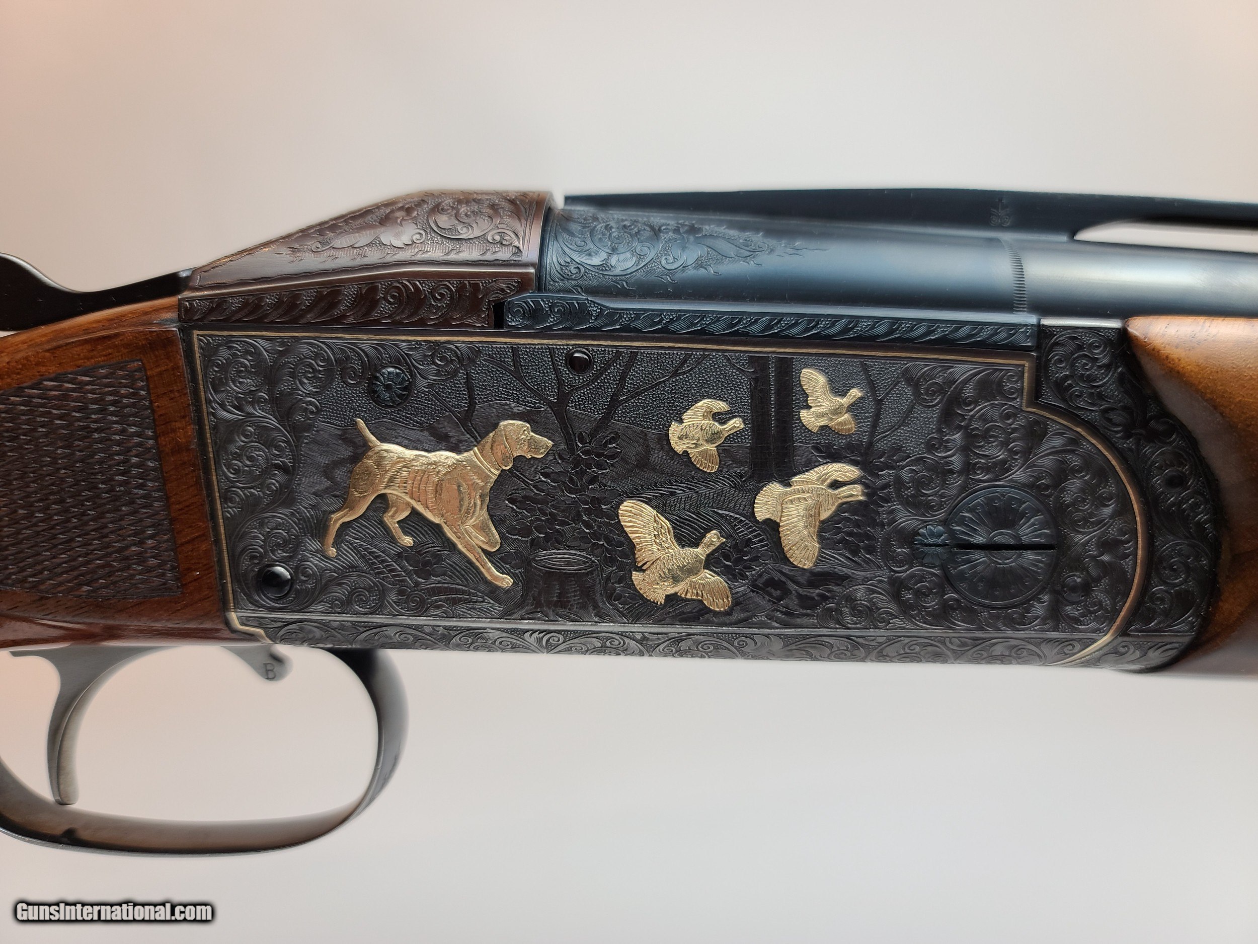

i got this off GI to show the different colors on a crown. look at the detail. there is no way someone is going to polish that. there has to be some chemical way.
i knew an old smith to say.... naval jelly. t/f?
#8 ·
Naval jelly is 2 kinds of acid, amongst a couple other ingredients. It turns rust into iron phospate, it can also mildly etch a surface. I wouldn't use it on that kind of gun, others yes, that one no. After all Blue and Rust Remover is a kind of acid product.
This company does restorations and on their page they say they polish the same way I do.
The cost of quality re-blue work is not in the application of finish, but in the preparation. We do not polish with hi-speed buffing wheels. We do the majority of surface preparation by hand, or by lathe polish.
This page has different techniques, along with a video
I found that gun out on GI. It is this one. There is a bit of apparent discoloration from the light source. We would need to see that gun in natural light to see if it is actually discolored.
With that said, I did some searching and out on the web there was a discussion of a Krieghoff being returned to Germany and the inlays had a color change from the refinishing being done on it.
Once again, the actual gun in question would have to be seen to truly find the best way to do it.
Just so everyone knows how to do it, if you are running Google Chrome, right click on the image. An option block will appear with one of the selections being "Search with Google Lens". Select that, adjust the brackets to fine tune what it is searching for and most times you can find what you are looking for on the web. To get out of the search, there is a little X over on the top right of the retrieved results.
#9 ·
swift river appears to do a lot of guns w/o engraving.
curious.
ive seen my smiths touch up areas they worked on with a dabb of fluid and it blended perfectly into the gun. he had numerous shades of chemicals.
could that receiver with engraving just be dabbed with solution on a cotton ball?
bob
#16 ·
the video still requires steel wool. on gold and engraving?
mmmeeeehhh.....
i may have no choice than to send it to KI.
i just wish i knew the trade secret.
#17 ·
I would never use steel wool on gold. it is softer than steel. 0000 (quad zero) steel wool will not scratch nor abrade a gun.
That is the grade I use, NEVER EVER any coarser as it will scratch the blueing.
There is also brass and bronze wool, both softer than steel.
When I touch up spots, I usually just rub it with a Q-tip while applying the Oxpho. The steel wool is just to shine it up. Little pieces can be used.
However, when in doubt and when dealing with an expensive firearm, sometimes it is best to let someone who has liability insurance handle it. If you send it to them, make sure that you have ample "before" photographs. And I would post them here, which will establish a timeline that can't be refuted.

#23 ·
CAREFULLY and it can be done . Gold will need to be removed REGARDLESS of who does what and then reapplied . Can't blue over Gold and who would want too o_O
Hot salts Bluing is a boiling caustic salt solution ,which can have additives introduced to vary color . S&W blue isn't Colt Blue or SKB ,it matters who does what . SEE their work prior to just having someone do it . I Know why Colt Blue is Nearly Black but I'm an old chemist and I'd damn well better know ;)
