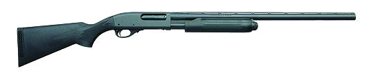

Here is my current set up - just a plain jane factory Remington 870 express "Super Magnum" 3.5" chamber with a 26" bbl and variable chokes. I would like to get a 20" bbl with sights and adjustable chokes. Can one get a longer magazine extension tube for a 20" bbl?

The longer your barrel the more extension tube you can fit.
If its for home defense, I wouldnt suggest going longer than 20" barrel. You wont want adjustable choke, you want an improved cylinder (open choke).
Working on a shotty is easy. You wont have any trouble at all. Only the bolt assembly can be a little tricky but its pretty self explanatory. Bolt group sits on the slide rails of the forend assembly.
Remove the forend grip. The magazine tube has a cap on it that screws off. Remove the cap, mag spring, follower and tube. Remove barrel. Install new barrel and new mag extension tube, new spring and follower. Install barrel clamp between new mag tube and new barrel for stability.
Follow the instructions with your new tactical forend grip and install it. Put it back on the shotty. Replace your buttstock as per instructions (one long bolt hidden by recoil pad).
