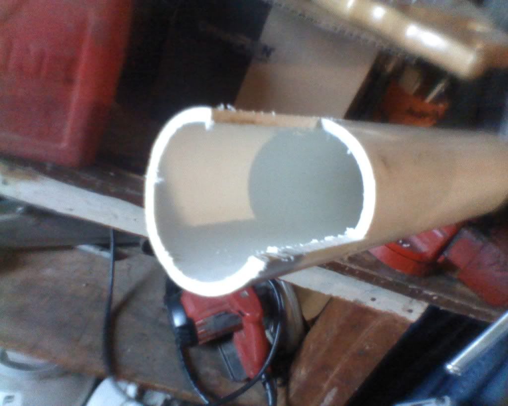

started with a piece of 3" PVC cut like this

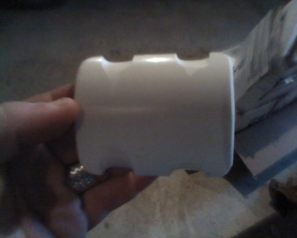

then i rounded and notched it on the bench grinder to accept the velcro straps i will add later

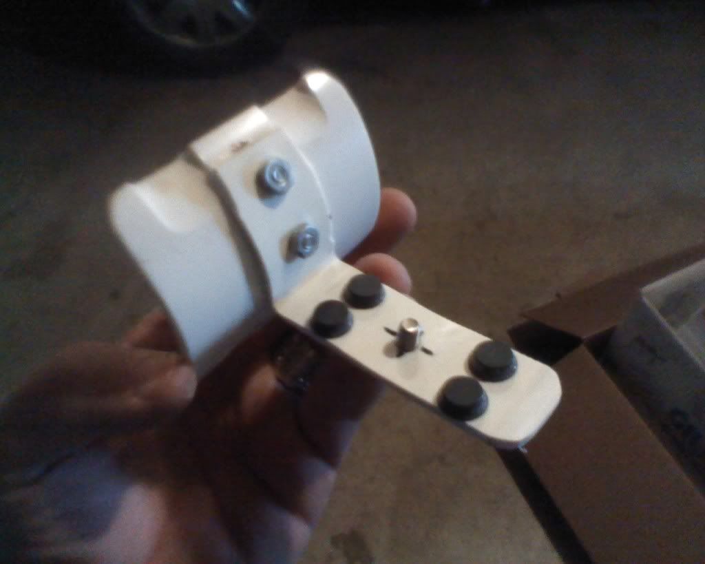

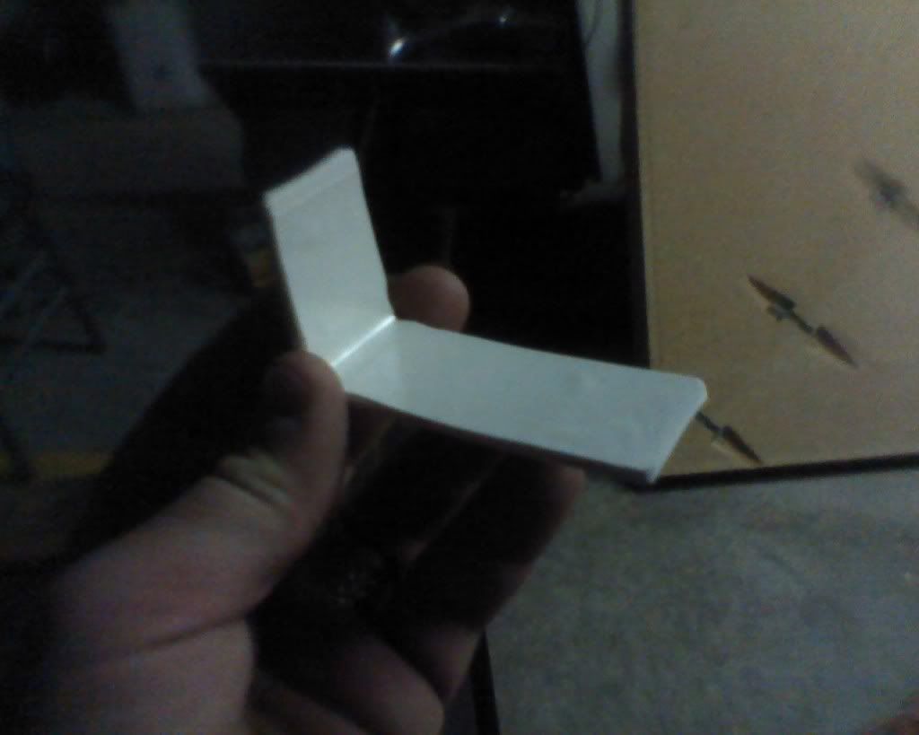

i made the camera shelf out of 2 sides of a PVC 2x4
I didnt take pics of all of the stuff here but i heated the camera shelf with a heatgun to make it match the profile of the base. i attached it with 2 small bolts that clear the forearm and barrel. and the camera is held in place with a bolt that threads into the tripod mount.

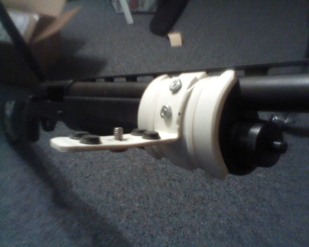

here it is on the gun

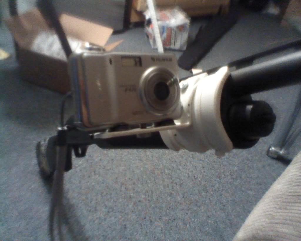

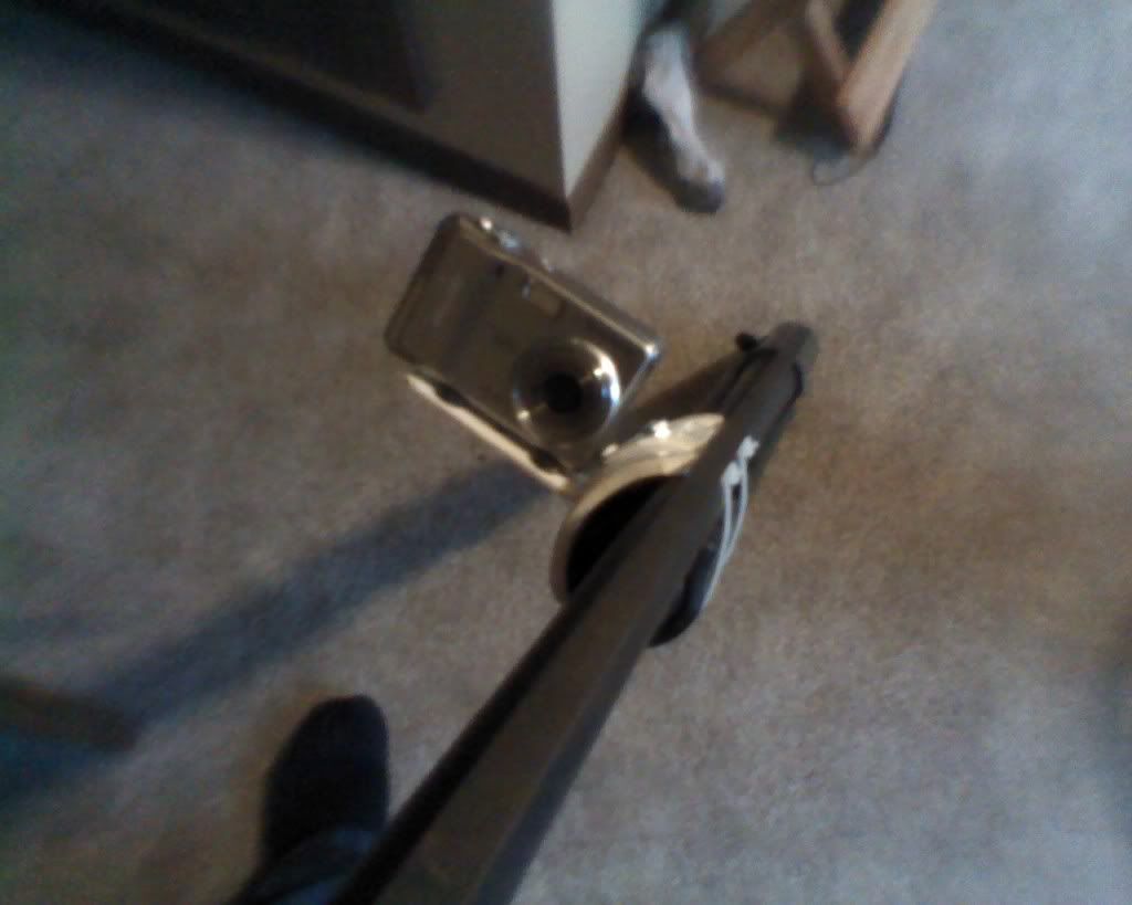

and with the camera
here is the video i made skip to 0:55 to see it in action cuz the start is the build process like above
and with the camera
